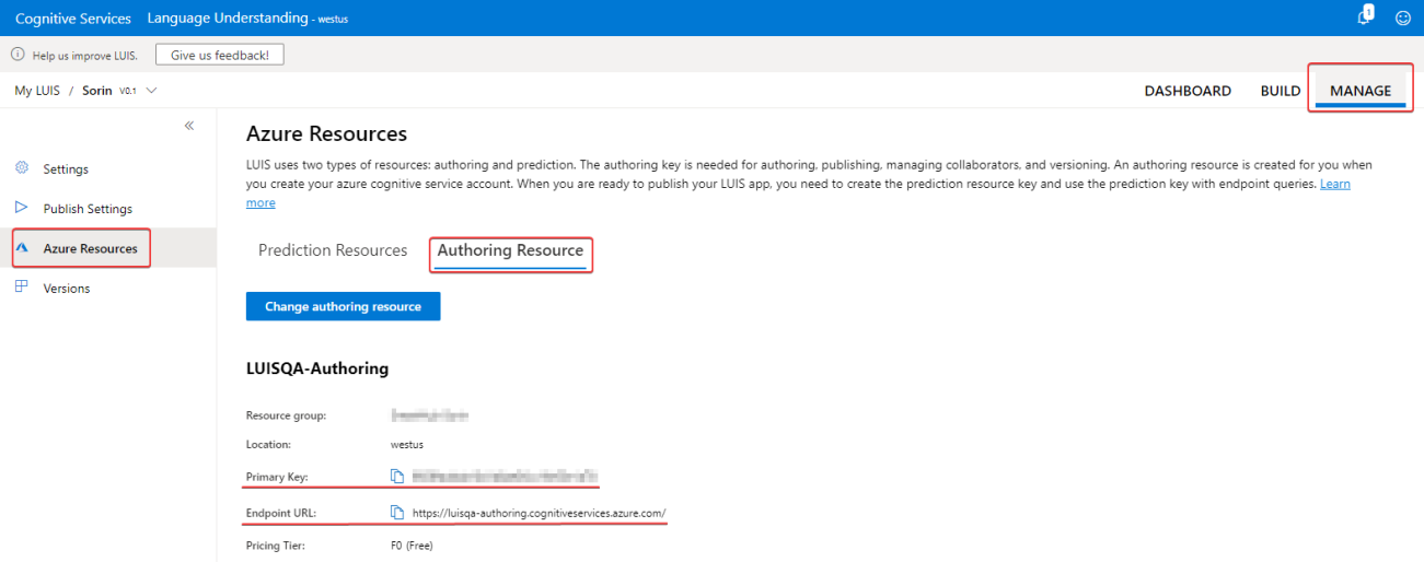

Application Settings in Azure
Access the Manage page to see the Application settings and all the information to complete the NLQ Service Configuration page.
  1. Get the Endpoint and Authoring key
    1. Select the Azure Resources entry from the left-side nav.
    2. The Authoring Key and Endpoint are shown in the screenshot below.

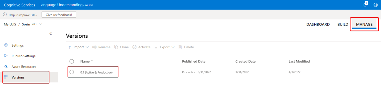

  2. Get the Version.
    1. The Version is shown in the screenshot below:
    2. For this case, the Version from NLQ Service Configuration page is 0.1.
